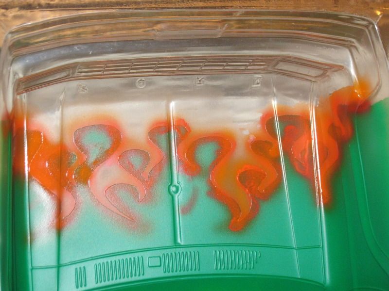

now onto the flames:
first i painted the red around the edges:
then i painted the orange after the red dried:

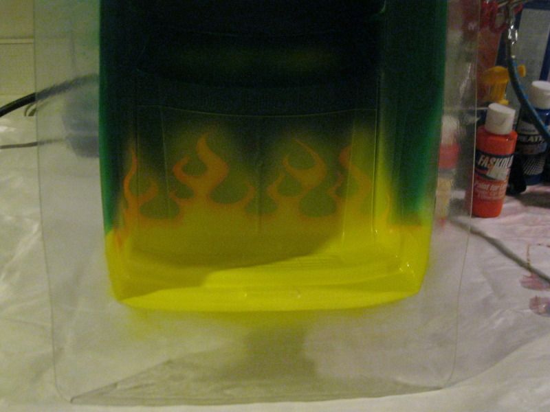

after the orange dried i painted the yellow in a few coats:
