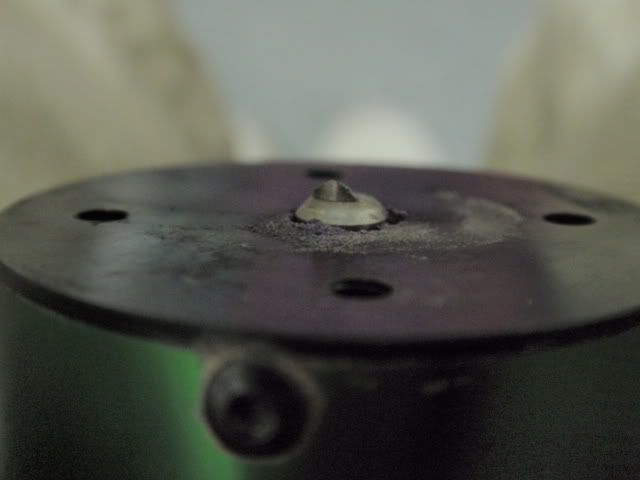

So here's a fun one. Has anyone had this happen to them? All I was doing was driving around in the dirt, not really gettin on it to hard. Gearing was 19/90 on a 7700 motor with a 2s 4000 mAh MaxAmps Pack. It wasn't even my bigboy 5000 TP pack.
I'm debating if i want to take it apart as Castle turn around takes a bit and I'm deployed. I have a 5700 C4 Big Stick motor that has a bad solder connection and I might just cannibalized that to keep running my 7700. Otherwise I have 2 new brushless motors in the mail. An Orion and some other off-brand 6800 motor. If i send it to Castle for repairs, that means a week shipped to them, and a week back to me. If the turn around at CC is over 6 weeks I'll be on my way home before it gets here and I'll still be out a motor. If anyone from Castle reads this, can I specify a separate shipping address so it can be returned to my home and be waiting for me?

Sorry about your motor shaft, but looking at that pic, it looks like your set screw may have come loose and the shaft was spinning inside the gear. See the fine metalic dust and the bluish tinge on the shaft surface? Maybe if you call Castle, you can get them to just send you a rotor, not sure how they will handle that if it is in or out of warranty.

That does suck! Even looks like the gear scraped the endbell.
With great power comes great responsibility, maybe a touch of blue Loctite on the setscrew next time.
