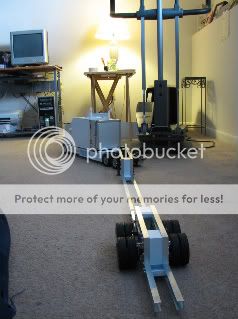

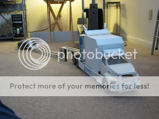

this my ford aeromax biuld.
Lots of custom parts made of styrene plastic.
I am making a car hauler with the trailer.

Awesome!
I'll be watching. Please complete this, lol.
So many of these projects get started on here never to be finished. It's very disappointing.

I am roaring to get this done. Still might be awhile though it keeps changing.

Man that thing is so big you'll need the Chrome Shop Mafia to trick it out. What kind of glue do you use on the styrene?

I use testor liquid cement on the plastic. And yes i use alot in a well ventilated room with a window fan.

was that a standard tamiya semi chassis?

No i had to make the chassis out of c channel aluminum. The same aluminum as the trailer chassis.

ok... I want a full DIY on how to build that rig, I've been wanting to build a semi for a while, and was going to buy the Tamiya next year

Where did you get the container box behind the sleeper? It looks like the real deal that Haz-Mat haulers use.

I made the box from a tamiya box trailer and cut it down to fit what i wanted.

can we get a build on the entire rig so far?
